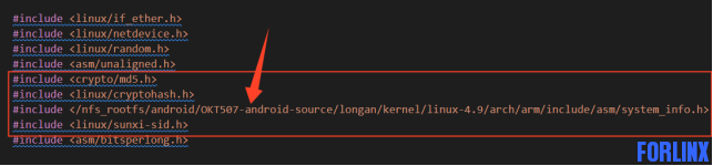

·添加头文件

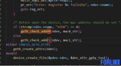

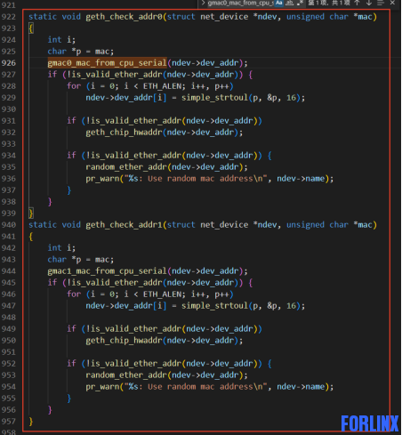

·修改随机生成MAC的部分,将函数geth_check_addr复制一份,分别将两个函数修改成geth_check_addr0和geth_check_addr1,修改内容如下
·此处分别添加0和1

·添加头文件
·箭头处的路径为绝对路径,要根据自己的实际情况修改。
·添加计算MAC地址的内容
static inline int gmac0_mac_from_cpu_serial(u8 *gaddr)
u32 inbuf[16]={0};
u32 outbuf[4]={0};
int ret;
ret = sunxi_get_serial((u8 *)inbuf);
printk("************Seria_forlinxl\t\t: %04x-----%08x-----%08x\n",inbuf[2], inbuf[1], inbuf[0]);
md5_transform(outbuf, inbuf);
printk("************Serial_md5_output\t\t: %08x-----%08x-----%08x\n",outbuf[0],outbuf[1],outbuf[2]);
gaddr[0] = (outbuf[0] >> 24) & 0xfe;/* clear multicast bit */
gaddr[1] = (outbuf[0] >> 16) | 0x02;/* set local assignment bit (IEEE802) */
gaddr[2] = outbuf[0] >> 8;
gaddr[3] = outbuf[0];
gaddr[4] = outbuf[1] >> 24;
gaddr[5] = outbuf[1] >> 16;
return 0;
static inline int gmac1_mac_from_cpu_serial(u8 *gaddr)
        u32 inbuf[16]={0};
        u32 outbuf[4]={0};
        int ret;
        gaddr[0] = (outbuf[1] >> 8) & 0xfe;/* clear multicast bit */
        gaddr[1] = outbuf[1] | 0x02;/* set local assignment bit (IEEE802) */
        gaddr[2] = outbuf[2] >> 24;
        gaddr[3] = outbuf[2] >> 16;
        gaddr[4] = outbuf[2] >> 8;
        gaddr[5] = outbuf[2];
        return 0;
