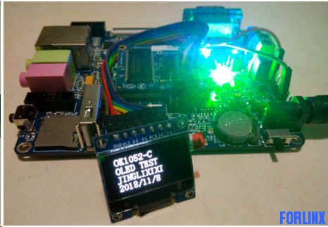

SPI 接口OLED屏显示效果
实现图示效果的主程序为:

    OLED_ShowString(8,0,"OK1052-C");
    OLED_ShowString(8,2,"OLED TEST");
    OLED_ShowString(8,4,"JINGLIXIXI");
    OLED_ShowString(8,6,"2018/11/8");
    while(1);
