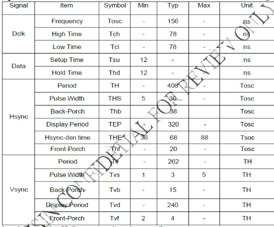

2.参考屏体手册中有:
3.修改设备树中

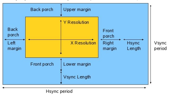

其中clock-frequency= fframe*(hfront+hback+hsync+xres)*(vfront+vback+vsync+yres)其中fframe=60

timing0: timing0 {
clock-frequency = <6410256>;
hactive = <320>;
vactive = <240>;
hfront-porch = <20>;
hback-porch = <38>;
hsync-len = <30>;
vback-porch = <15>;
vfront-porch = <4>;
vsync-len = <3>;
hsync-active = <0>;
vsync-active = <0>;
de-active = <1>;
pixelclk-active = <1>;

5.如果发现屏幕闪烁,根据分频设置,适当调整频率。
或未在中心位置。微调下面6个参数。
hfront-porch = <20>; hback-porch = <38>; hsync-len = <30>; vback-porch = <15>; vfront-porch = <4>; vsync-len = <3>;

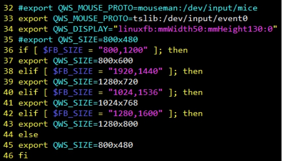

6. 修改文件系统目录下/etc/rc.d/qt_env.sh,根据实际需求调整QWS_SIZE的大小。
